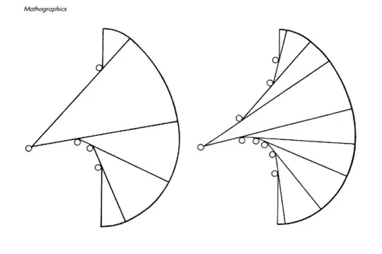

In Mathographics Robert Dixon shows how to draw an Egg-curve (or really half of an egg curve) as an involute:
This allows you to draw a smoother version of eggs created from the 'arcs of a circle method.'
I want to know the formula for idealized involute curves of this type (i.e., 0-D pins, and 0 width string, etc....):
What is the formula for parametric equations for points, $(x_1, y_1), (x_2, y_2), (x_3, y_3)..., (x_n, y_n)$, given a starting point $(x_f, y_f)$ and a point $(x_O, y_O)$ where the string is attached?

    @Moo Thank you. I've read that paper. So far as I can tell, it gives good instructions for the geometric constructions made with circle arcs (which I view as approximations of the involute, like a 'spiral' made from circle arcs can approximate a logarithmic spiral).
    What I'm looking for are the parametric equations of the 'string, pins, and pen' involute given by Dixon (see image attached in post).

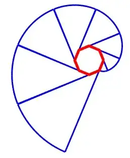

Have a look at Fig. 1 modelizing the position of the extremity of a string rolled/unrolled along a convex polygon (here the particular case of a regular octagon) generating a kind of spiral (modelizing rather well a half-egg-shape) ?
Fig. 1.

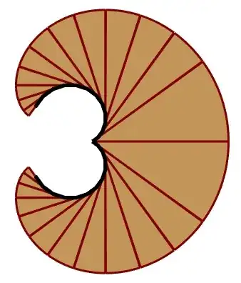

Last but not least, being a Frenchman, I don't resist the pleasure to offer you a "croissant" (with eggs entering into its composition :)) :
Fig. 3.

  • But you see that I haven't attempted to provide any equation... – Jean Marie Mar 26 '24 at 14:50

  • Yes, I think that the possibilities offered by this way of connecting arcs of circles has its own limits. I have been working on them for the design of constant diameter convex curves (called "wheels" : see my detailed answer here). Besides, see the third drawing I just added. – Jean Marie Mar 26 '24 at 18:23
