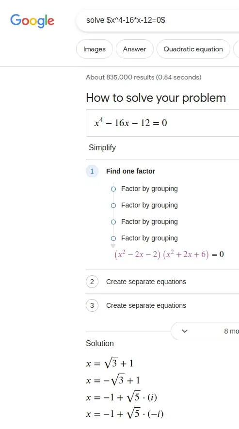

Alternatively, there are on-line solvers also for this equation as follows for instance:
solution for sqrt x

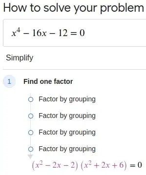

Now there is also consistency. From the online Equation solver, there is also consistency that verifies this result:
online equation solver tractability
Since $a$ is positive, and $b_+>b_-$, the online equation solver has results for $a$, $b_+$, and $b_-$, namely $a$ =2, $b_+=6$, and $b_-=-2$.
The three Equations, namely $(b_+ + b_- - a^2)=0$, $(a*(b_+ - b_-))=16$, and $b_+*b_-=-12$, can be tested against the online results to find any algebraic errors, applying $a$ =2, $b_+=6$, and $b_-=-2$. There is no mistake is in Equations 9, and the values given by the online Equation Solver are correct, also yielding the desired consistent result:
