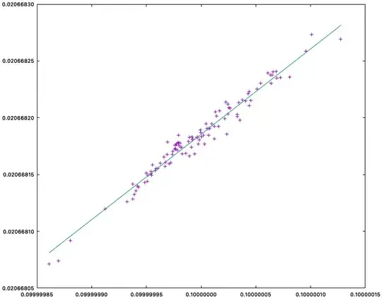

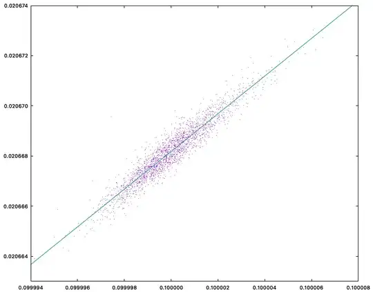

In the present setup, we’re not taking independent samples of $X$, but the situation is similar in that if we rotate the quadrature grids in a way that makes $X$ come out too high, $X^2$ will probably also come out too high. Here are plots of the quadrature result for $X$ versus $X^2$. The first plot is with lots of results on a smaller grid (of order $53$ with $974$ points), and the second one with fewer results on the full $5810$-point grid. (Each of the latter runs has to evaluate $5810^3\approx2\cdot10^{11}$ triangles, so I only did $108$ of those.)
scatter plot for smaller grid
scatter plot for larger grid
The slope of the regression line is about $0.7$, so the effect is considerably stronger than in the purely random case (where it would have been $2\langle X\rangle=0.2$). Substracting out the fitted linear function reduces the sample standard deviation from $1.2\cdot10^{-6}$ to $3.7\cdot10^{-7}$ for the smaller grid and from $3.6\cdot10^{-8}$ to $6.4\cdot10^{-9}$ for the larger grid, so we gain almost a full significant digit by making use of the known exact value of $\langle X\rangle$. The result for the larger grid is
$$\langle X^2\rangle=0.02066818545(62)\;,$$

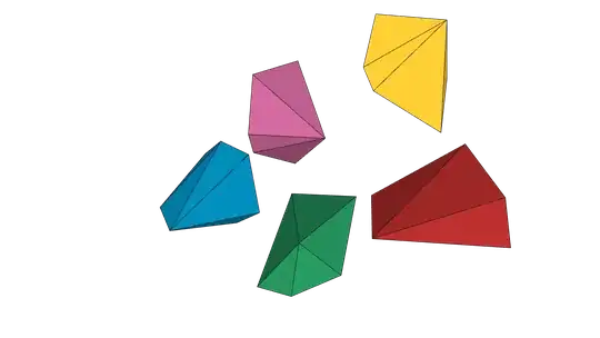

I also created 3D visualizations of the different types of simplicial octahedra and decahedra. Unfortunately they can’t be embedded here, but you can view them here (octahedra) and here (decahedra). The structure is easier to see if you select “Show Edges” in the preferences. You can click on the cube icon in the left sidebar to get a list titled “Meshes”, where you can see the degree sequences and switch individual polyhedra on or off (eye icon) or zoom in on one of them (four-arrow icon). Here’s a snapshot of the decahedra:
snapshot of the types of simplicial decahedra
