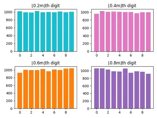

In an attempt to develop intuition I recurred to this Python script, which plots the frequency of each digit of $2^n$ in positions $\left\lfloor\dfrac 15m\right\rfloor, \left\lfloor\dfrac 25m\right\rfloor, \left\lfloor\dfrac 35m\right\rfloor, \left\lfloor\dfrac 45m\right\rfloor$, where $m$ is the total number of digits.

freq1 = [0, 0, 0, 0, 0, 0, 0, 0, 0, 0] freq2 = [0, 0, 0, 0, 0, 0, 0, 0, 0, 0] freq3 = [0, 0, 0, 0, 0, 0, 0, 0, 0, 0] freq4 = [0, 0, 0, 0, 0, 0, 0, 0, 0, 0]
a = 2 # power basis for n in range(10000): p = str(a*n) # power m = len(p) # number of digits freq1[int(p[int(0.2m)])]+=1 freq2[int(p[int(0.4*m)])]+=1 freq3[int(p[int(0.6*m)])]+=1 freq4[int(p[int(0.8*m)])]+=1
The code produces the following graphs.
The distribution seems to be approaching uniformity. The same behavior was observed for several other basis. This is my conjecture:
Conjecture. Given an integer $a>1$ not divisible by $10$, a digit $d$ and $\lambda\in(0,1)$, we have $$\lim\frac{\#(\{n:\text{ the }\lfloor\lambda m(a^n)\rfloor\text{th digit of }a^n\text{ is }d\}\cap[1, N])}{N} = \frac1{10}.$$ where $m(x)\equiv\lfloor\log_{10} x\rfloor$ is the amount of digits of $x$.

    It seems to get more uniform. For $n = 1$ to $10000$ I get frequencies $983, 950, 1001, 1003, 998, 989, 994, 1015, 1005, 1062$. Very much like what you would expect from a random sequence of digits. – Robert Israel Mar 03 '24 at 18:28
