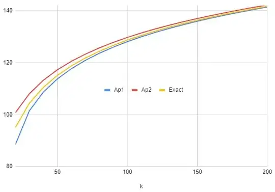

This approximation is similar to that of Mike Earnest, the graph displays $\log S_{n,k}$ for $n=18$ ("Ap1" is approx $(3)$, "Ap2" is Mike Earnest's)
It's also a lower bound, of course, because it omits some valid configurations.
Plugging in $(3)$ the Stirling approximation (first order) we get
$$S_{n,k} \approx (2 k n/e)^n$$
in agreement with your guess.

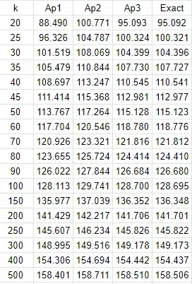

This approximation (lets call it "Ap3") is based on the same approach given in the link above (kind of Poissonization), I can provide details if anyone is interested. It gives values that are practically indistinguishable from the exact values in the graph above.
Here's a table of values of $\log S_{n,k}$, for $n=18$.

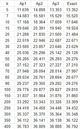

and for $n=5$
