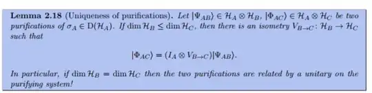

I am trying to prove the following
For this I should use the following fact:
Let $ρ_A = \sum_{i=1}^r p_i|e_i⟩⟨e_i|$, where $p_i$ are the nonzero eigenvalues of $ρ_A$ and $|e_i⟩$ corresponding orthonormal eigenvectors Then,any purification $|\psi_{AB}⟩$ of $ρ_A$ has a Schmidt decomposition of
the form $|\psi_{AB}⟩ = \sum_{i=1}^r s_i|e_i⟩ ⊗ |f_i⟩$
(i.e with the same $|e_i⟩$ as in $ρ_A$)
Using this fact I can write indeed
and
$|\phi_{AC}⟩ = \sum_{i=1}^r \tilde s_i|e_i⟩ ⊗ |\tilde f_i⟩$
(I am not sure if $ \tilde s_i=s_i $)
Then I thought I could define a linear map: $V_{B \to C}:H_B\to H_C: v \mapsto Dv$
where C is the change of basis matrix. If I can prove that this is an isometry I am practically done. So I have to prove that: $ V_{B \to C}^\dagger V_{B \to C}=I_{H_B}$
This is where I am having trouble. Is a the linear map given by the change-of-basis matrix between complex (finite dimensional) Hilbert spaces given by a hermitian matrix? If so , how do I prove it ? If not, it looks like this definition or the approach at all does not work, how do I prove the isometry then?
