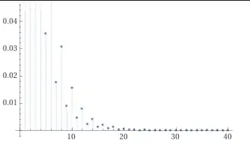

Part answer to the last side note:
I've managed to plot this via Wolfram Alpha and the result is quite interesting in that - contrary to my intuition - the probability of having >= n/2 identical sides of any die face (e.g. half or more than half 1s) decreases rapidly:
n=2 to 40
Martin
