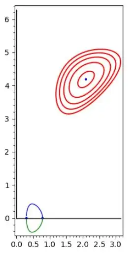

WLOG, we can assume that one of the points is $A=(1,0)$ and the two others are $B=(\cos u, \sin u)$, $C=(\cos v, \sin v)$.
We can assume (see figure below) that $u \in [0, \pi]$, and $v \in [\pi,2 \pi]$. indeed, cases where $\pi < v <u$ or $u<v<\pi$ do not contribute to the region of plane $(u,v)$ we are interested in.
Using the formula given by @kabenyuk
$$r/R=\cos A+\cos B + \cos C-1$$
which becomes, with $R=1$ and level line $r_0=\sqrt{2}-1$ :
$$r=\cos((v-u)/2)+\cos((2 \pi - v)/2)+\cos(u/2)-1 \ge r_0$$
Otherwise said, we are interested in level line
$$r=r(u,v)=(\cos(u/2)-\cos(v/2))+(\cos((u-v)/2)-1)=r_0\tag{**}$$
Therefore, in a $(u,v)$ coordinate system (see figure), region (R) is the interior of the largest of the represented level lines of the function described by $(**)$ for $r$ ranging from $r=r_0$ to its extreme value $r_{max}=\tfrac12$, achieved in the single point with coordinates $(u,v)=(\tfrac{2\pi}{3},\tfrac{4\pi}{3})$, which, in a natural way, corresponds to the equilateral triangle case.
But (**) can be written :
$$-2 \sin\left(\tfrac14(u+v)\right)\sin\left(\tfrac14(u-v)\right)-2\left(\sin\left(\tfrac14(u-v)\right)\right)^2=\sqrt{2}-1\tag{***}$$
Consider now the following change of variable which can be interpreted (in a reverse way) as a linear transformation $(L)$ :
$$\begin{cases}a&=&\tfrac14(u-v)\\b&=&\tfrac14(u+v)\end{cases},$$
allowing to write (***) under the factorized form :
$$-\sin a (\sin a + \sin b) = k \ \ \ \text{with} \ k = \frac{r_0}{2}=\frac{\sqrt{2}-1}{2}$$
$$\sin b = \sin a - \frac{k}{\sin a}$$
which gives (in order for variable $b$ to take positive values) :
$$b=\operatorname{asin} \left(\frac{k}{\sin(a)}-\sin(a)\right)+\frac{\pi}{2}$$
We have obtained in this way function $f$ given at the beginning in (0). With its twin function $-f$, the union of their curves, represented in blue and green resp. in figure 1, can clearly be interpreted as the image of the initial level curve by transformation (L). Therefore we have to multiply the integral of $f$ by $2$ (in order to account of $-f$), then by $8$, in order to recover the area of the initial shape. Why $8$ ? Because it is the inverse jacobian of linear transformation (L) (whose determinant is $1/8$). Therefore, we must multiply the area between the blue curve and the $u$-axis by $16$ in order to retrieve the initial area.
Now, how can we express the probability out of this relative area ? The area value obtained just above must be divided by the total area $2\pi^2$ (enclosed by black axes in the figure) under the assumptions of uniform distribution of angles $u,v$, ending the proof of formula (*).
Have a look at the SAGE program below giving some complementary information.
Fig. 1 : Representation in the $(u,v)$ plane. The small oval shape is the image of the big one (the largest of level lines) by linear transform $(L)$.

 e=cos(x/2)-cos(y/2)+cos((x-y)/2)-sqrt(2)
 g=point([[2*pi/3,4*pi/3],[x0,0],[x1,0]])
 g+=line([[pi,0],[0,0],[0,2*pi]],color='black')
 nll=5;# number of level lines
 for a in range(nll) :
    g+=implicit_plot(e-a/50,(x,0,pi),(y,-0.4,2*pi),color='red')
 g+=parametric_plot((t,f(t)),(t,x0,x1),plot_points=400,color='blue')
 g+=parametric_plot((t,-f(t)),(t,x0,x1),plot_points=400,color='green')
 g
