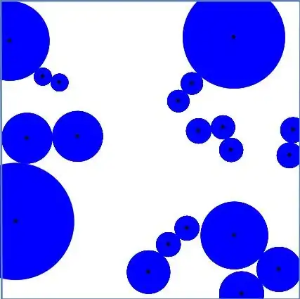

A square lamina contains $n$ independent uniformly random points. At a given time, each point becomes the centre of a disc whose radius grows from $0$, at say $1$ cm per second, and stops growing when the disc hits another disc.
Consider the discs after all growth has stopped. Here is an example with $n=20$.
Let $P=$ proportion of the square that is covered (i.e. occupied) by the discs. In the example above, $P\approx0.383$.
What does $P$ approach as $n\to\infty$ ?
The shape of the lamina (for example, square) does not matter, since we are taking $n\to\infty$. The rate of growth (for example, $1$ cm per second) does not matter, as long as all the discs start growing at the same time and grow at the same rate.

Attached a MATHEMATICA script which generates a set of random circles as needed. The calculation process could be more efficient but it would also be less transparent.

The proposed setup.
A random setup

  • I think there is something wrong with the first image (with the dark blue disks). There is a general rule: If a disk, call it $A$, touches exactly one other disk, call it $B$, then $B$ cannot be bigger than $A$. But this rule is not always obeyed in the image. – Dan Jan 27 '24 at 06:23
  • @Dan I hope I have fixed the problems with the drawing algorithm. – Cesareo Feb 04 '24 at 18:28
  • @Cesareo Yes, it looks correct now. – Dan Feb 05 '24 at 00:36
