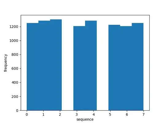

The manga claims that there are most-likely and least-likely three-letter sequences. The most-likely sequences are "UUD", "UDD", "DDU", and "DUU." The least-likely sequences are "DDD" and "UUU." I don't understand why this is the case. My naive intuition tells me that all $2^3=8$ three-letter sequences are equally likely to appear in the dealer's sequence. I confirmed it with my Python script:

plt.xlabel('sequence') plt.ylabel('frequency') plt.hist(data) plt.show()
This histogram counts the number of occurrences for each three-letter sequence "DDD" (0), "DDU" (1), "DUD" (2), "DUU" (3), "UDD" (4), "UDU" (5), "UUD" (6), "UUU" (7). If the manga's claim is true, then I should see some kind of normal distribution in the histogram. The histogram clearly shows that each sequence are equally likely, so the manga might be wrong or there is something wrong with my simulation.

You have to be careful: it's not the probability of the occurrence of a dice you want to minimize, but it's time to show up the first time, i.e. the expected number of throws.
Indeed what you write is true: all sequences of symbols have the same probability a priori, but the average time it takes to reach one differs.
For example, if you were looking for a DDD but you throw DDU you need at least 3 more throws to possibly reach it, whereas if your choice would have been DUD just one more throw is needed. Basically you need to take into account also "recovering" from a bad throw.
Since your dice is basically a coin, following this answer you can find that the expected number of tosses for DDD is 14, and the number for UUD can be calculated analogously to that answer and you obtain just 8.
The 8 comes from the equation: $$x=\frac12(x+1)+\frac14(x+2)+\frac14\cdot (2+2)$$

  • Ah, I see. According to the another answer in the linked question, this game is an example of Markov process. I can find the most-likely and least-likely sequences by calculating the stationary distribution for that Markov chain! – Jimmy Yang Dec 23 '23 at 07:54
  • This is indeed the case. – b00n heT Dec 23 '23 at 07:55
