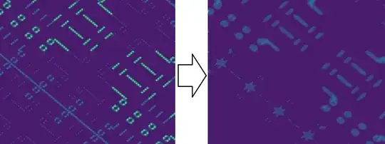

Let $u : \mathbb R^n \to \mathbb R$, and define $☯^1u : \mathbb R^n \to \mathbb R$ to be the traditional heat transfer of $u$ in a uniform material after $1$ second of time. For example, in this figure we have on the left $u : \mathbb R^2 \to \mathbb R$, and on the right is $☯^1u$.
(Note that ☯ is only defined up to choices of constants but don't let that stop you from solving this problem)
Traditional direction of heat transfer
Here is my question. Is it possible to reverse this arrow here? Given a $v : \mathbb R^n \to \mathbb R$, how can we find a $u : \mathbb R^n \to \mathbb R$ and $t \in \mathbb R^{>0}$ such that $☯^tu = v$? By an abuse of notation, what I want to do is receieve a vector $v$ and "compute" $☯^{-s}v$ for $s>0$.
