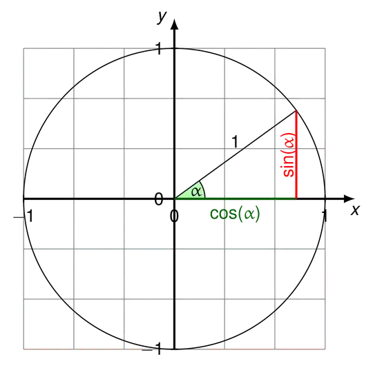

Now what happens if we want to rotate (1,0) and (0,1). Let's start with (1,0): (1,0) is in the unit circle, so a rotation by an angle of $\theta $ of this point will still remain on the unit circle, since a rotation is an isometry and preserves lengths. The x and y coordinate of the rotated point are than $(\cos(\theta),\sin(\theta)) $, you can verify this by drawing a triangle : enter image description here
So we have $\phi((1,0))=(\cos(\theta),\sin(\theta))$
In the same way we can do this for (0,1) : Draw a circle and rotate the point (0,1) by a clockwise rotation of an angle $\theta$. After you did that try to find its respective coordinates after the rotation(you can draw a triangle again). What you will get is : $\phi((0,1))=(-\sin(\theta ),\cos(\theta))$.
