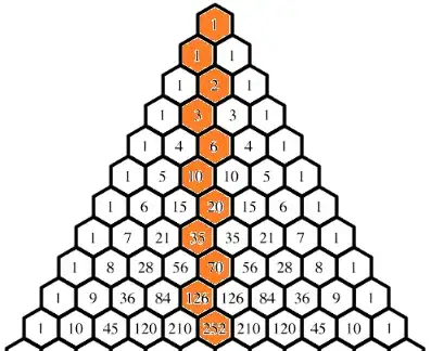

On Pascal's triangle with any number of rows, draw the three medians.
For each median, calculate the product of the numbers that zig-zag along that median.
The three products are always equal! (proof below)
Note that, on the vertical median, every other number is either just to the left, or just to the right of the median; it makes no difference. On the oblique medians, every other number is just below the median (this rule applies when the number of rows is even or odd).
Here is an example with a triangle with $10$ rows (the top $1$ is row $0$):
$1\cdot 1\cdot 2\cdot 3\cdot 6\cdot 10\cdot 20\cdot 35\cdot 70\cdot 126\cdot 252=560105280000$
$1\cdot 6\cdot 15\cdot 35\cdot 35\cdot 56\cdot 28\cdot 36\cdot 9\cdot 10\cdot 1=560105280000$

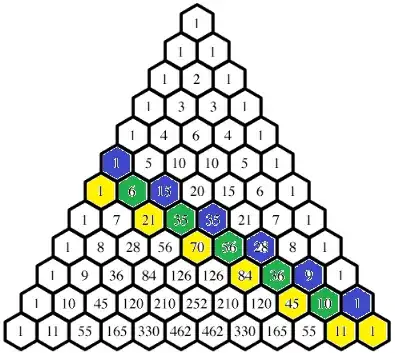

In the diagram,
$P_o(10)$ is the product of the numbers in blue and green.
$P_o(11)$ is the product of the numbers in yellow and green.
$\begin{align} \dfrac{P_o(11)}{P_o(10)}&=\dfrac{\binom{6}{0}}{\binom{5}{0}}\cdot\dfrac{\binom{7}{2}}{\binom{6}{2}}\cdot\dfrac{\binom{8}{4}}{\binom{7}{4}}\cdot\dfrac{\binom{9}{6}}{\binom{8}{6}}\cdot\dfrac{\binom{10}{8}}{\binom{9}{8}}\cdot\dfrac{\binom{11}{10}}{\binom{10}{10}}\\ &=\dfrac{6}{6}\cdot\dfrac{7}{5}\cdot\dfrac{8}{4}\cdot\dfrac{9}{3}\cdot\dfrac{10}{2}\cdot\dfrac{11}{1}\text{ because }\dfrac{\binom{p}{r}}{\binom{p-1}{r}}=\dfrac{p}{p-r}\\ &=\binom{11}{5}\\ &=\dfrac{P_v(11)}{P_v(10)}\\ \end{align}$
Or in general,
$\begin{align} \dfrac{P_o(2n+1)}{P_o(2n)}&=\prod\limits_{k=0}^n \dfrac{\binom{n+1+k}{2k}}{\binom{n+k}{2k}}\\ &=\prod\limits_{k=0}^n \dfrac{n+1+k}{n+1-k}\\ &=\binom{2n+1}{n}\\ &=\dfrac{P_v(2n+1)}{P_v(2n)}\\ \end{align}$
A similar argument shows that $\dfrac{P_o(2n)}{P_o(2n-1)}=\dfrac{P_v(2n)}{P_v(2n-1)}$.
$\therefore\dfrac{P_o(a+1)}{P_o(a)}=\dfrac{P_v(a+1)}{P_v(a)}$ for all $a\in\mathbb{N}$.
