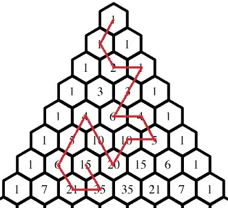

Let's take a random walk on Pascal's triangle, starting at the top. Each number is in a regular hexagon. At each step, we can move to any adjacent hexagon with equal probability, but we cannot revisit a hexagon. The walk ends when we cannot move.
Here is an example in which the final number is $15$.
Does the final number have infinite expectation?
(Paradoxically, a random variable whose possible values are all finite, can have infinite expectation.)
