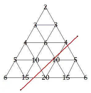

Consider Pascal's triangle with $n$ rows, without the $1$s, with each number corresponding to a vertex on a pyramid of equilateral triangles, as shown below with example $n=5$.
Can the triangle be divided by a straight line (that does not pass through any vertex) into two regions of equal sums?
(That is, does there exist an $n$ such that Pascal's triangle with $n$ rows, without the $1$s, can be divided by a straight line into two regions of equal sums?)
For example, with $n=5$, the red line below fails to divide the triangle into two regions of equal sums: the upper-left region has a sum of $58$, and the bottom-right region has a sum of $56$.
I have tried to do this with different size triangles, without success. It seems that it cannot be done, but I don't know how to prove it.

    Put a vertical line in the middle ;) – LL 3.14 Nov 28 '23 at 12:28
  • @LL3.14 I edited to clarify that the line does not pass through any vertex. – Dan Nov 28 '23 at 12:33

    I advise you to use the "left-justified" version of the Pascal triangle, as you can see some in the -good- Wikipedia article on Pascal's triangle. This version can be obtained by a linear transformation from the "isosceles" usual form : the image of the separating line will still be a straight line, and the subsequent computations are simpler. – Jean Marie Nov 28 '23 at 21:08
  • @JeanMarie With your computer program, what value(s) of $n$ (number of rows) did you use? – Dan Nov 28 '23 at 21:44
    Till $n=21$ if I recall well. – Jean Marie Nov 28 '23 at 21:45
