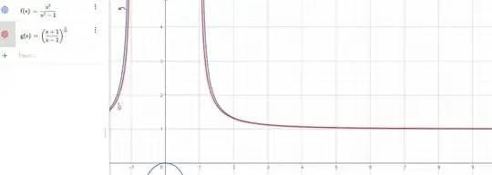

We need to prove that: $$a_{k-1}>a_{k} $$ $${a_{k-1}}^2>a_{k}^2$$ $$\left( \frac{k}{k-1} \right)^{2k-1}> \left( \frac{k+1}{k} \right)^{2k+1}$$ $$(k)^{4k} >({k+1})^{2k+1} ({k-1})^{2k-1}$$ Here I tried to use the binomial theorem to prove that $(k)^{4k} >({k+1})^{2k+1} ({k-1})^{2k-1}$, or in other form $\left(1+ \frac{1}{k^2-1} \right)^{2k} > 1+\frac{2}{k-1}$, but the sequence $\left(1+ \frac{1}{k^2-1} \right)^{2k} - 1-\frac{2}{k-1}$ converge TOO fast to $0 $ and after a lot of calculations I realised that I need to use most or all the terms in the expatiation of $\left(1+ \frac{1}{k^2-1} \right)^{2k}$ so that the RHS >LHS, so the this approach lead to a dead end. enter image description here

I noticed that the inequality $a_{k-1}>a_{k} $ implies that $ \frac{k}{\sqrt{(k+1)(k-1)}}>\left( \frac{k+1}{k-1}\right)^{\frac{1}{4k}}$ which is an inequality include $\frac{AM}{GM}$​. (I don’t know if this is useful, but it was very interesting and for me it was a dead end.)
I also tried to to prove $ \frac{2k^3}{{2k (k+1)(k-1)} }>\left( \frac{k+1}{k-1}\right)^{\frac{1}{2k}}$ (I multiplied the RHS bt $\frac{2k}{2k}$ to use the AM-GM inequality) the RHS will be $$\frac{2k +\frac{1}{k-1} +\frac{1}{k+1} }{2k}$$ I tried to find an $2k$ sequence of positive numbers st their sum is ${2k +\frac{1}{k-1} +\frac{1}{k+1} }$ and their product is $ \frac{k+1}{k-1}$ to use the AM-GM inequality but I also couldn't.
