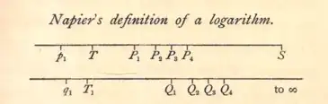

From Hobson's book
Imagine a line $TS$ of length $R$ (= $10^7$), along which a point $P$ moves from $T$ to $S$ such that its velocity is proportional to its distance from $S$. Meanwhile, another point $Q$ on a different line, starting at $T_1$ when $P$ is at $T$, moves at uniform velocity (the velocity of $P$ when at $T$).
DEFINITION: If when the point $P$ is at $P_1$ the point $Q$ is at $Q_1$, then the logarithm of the length $P_1S$ is defined to be the length $T_1Q_1$.
So $l(R)=0$ and $l(x) \to \infty$ as $x \to 0^+$. Also $l(x)<0$ for $x>R$.
Napier showed, with an essentially sound argument, that when $Q_1, Q_2, \dots$ are covered after equal times, i.e., the lengths $T_1Q_1, T_1Q_2, \dots$ are in arithmetic progression, then the lengths $P_1S, P_2S, \dots$ are in geometric progression. This is the proposition mentioned above.

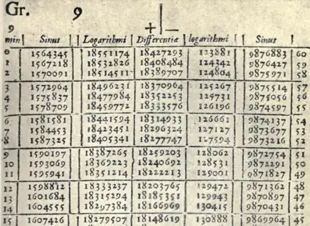

To be precise, Napier's table gave the "logarithms" of sines of angles from $0^\circ$ to $90^\circ$. The then definition of $\mathop{Sine} \theta$, dating all the way back from Aryabhata in the 5th century, was (for some fixed radius $R$) the length of the half-chord that subtends angle $\theta$ in a circle of radius $R$. In modern notation, $\mathop{Sine} \theta = R\sin \theta$. Napier chose $R = 10^7$. (So $\mathop{Sine} 0^\circ = 0$ and $\mathop{Sine} 90^\circ = 10^7$.) His table gave the "logarithms" of the Sines of equidistant angles, so although it gave logarithms of numbers from $0$ to $10^7$, these numbers were not equally spaced. Here is part of a page from his tables (see more here):
Part of a page from Napier's tables, from Hobson's book
The last row says (in modern notation, and omitting digits after the decimal point) that $10^7\sin(9^\circ 15') = 1607426$, that $l(1607426) = 18279507$ (actually it should have been $18279511$), and reading from the right, it gives the Sine of the complement angle $80^\circ 45'$ (or equivalently the Cosine of that angle), the logarithm of that Sine, and the difference between the two logarithms (useful essentially because $\log\sin\theta -\log\cos\theta=\log\tan\theta$, etc).
