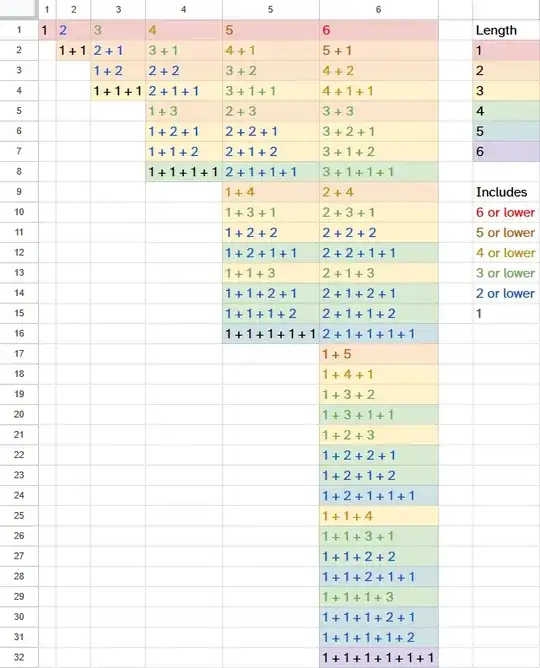

For reference, here are the compositions of integers $1$ through $6$, color-coded by length (background color) and highest number (text color):
Compositions of integers 1 through 6, color-coded
