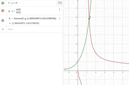

One to approach this is to let $y=4^x$. That's a nice exponential curve that you can plot easily enough on any graph plotter.
That leaves you with $x^y=4$
Taking logarithms gives you $y \ln x=\ln 4$ or $y=\frac{\ln 4}{\ln x}$. Not so nice, but again, it's a curve that you can plot.
Where the two curves intersect will be the solution to your question.
It's not an algebraic method, but it gives you some insight into what's going on.
tomi
  • 9,594
    Your $4^x=\frac{\ln4}{\ln x}$ can be reduced to $\log_4{x}=4^{-x}$ or, if you like, $\log_x{4}=4^x$, keeping $f$ the same. – sreysus Sep 28 '23 at 14:37
