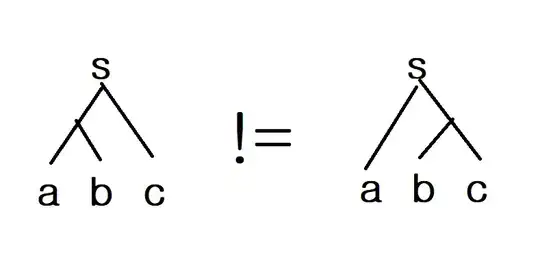

Let's say, there's a sentence with $3$ words, $a$, $b$, and $c$.
We can analyze this sentence by structuring "syntactic trees" in $3$ ways.
Then, I deleted all the middle nodes between a root and $a,b$, and $c$. Here's a picture of this process.
"3-word sentence and its syntactic trees"
Of course, there can be a tree which looks like this.
"Tree that has a middle node which has a single child node"
But I would like to say that the 3rd tree in the first picture and this tree in the 2nd picture are same, because I can say that both node $a'$ and node $a''$ are referring to exactly same thing which is the node $a$.
Every time I do the analysis, I will delete all the nodes from the tree except the root and last nodes without any child.
When I apply this rule to analyze $4$ 'word' sentence, I will get these trees.
"4-word sentence and its syntactic trees"

    You can search the first few terms of this sequence on the OEIS and you get A001003, apparently called the "super Catalan numbers" or "little Schroeder numbers": https://oeis.org/A001003 The asymptotic behavior is a constant times $\frac{(3 + \sqrt{8})^n}{n^{3/2}}$ and there's a generating function and recurrences you can use to calculate larger terms. – Qiaochu Yuan Sep 23 '23 at 07:46

Firstly, your "syntactic trees" of order $n\geq 2$ are essentially Schröder trees; ordered trees with $n$ leaves and with no vertices of outdegree $1$ (for $n=1$ we adopt the convention that the trivial tree with no edges and one leaf is the unique Schröder tree with one leaf, denoted $\epsilon$). We shall derive a closed form and simple asymptotic for the number of $n$-leaf Schröder trees using the theory of generating functions.
Let $\mathcal{T}$ be the set of Schröder trees (with any number of leaves). Let $t_n$ be the number of Schröder trees with $n$ leaves, and define the generating function
$$T(x)=\sum_{n\geq 0} t_n x^n$$
The key insight here is to notice that every Schröder tree is either $\epsilon$, or has a root with at least two (ordered) branches, each attached to a Schröder tree. More formally, there exists a natural isomorphism
$$\mathcal{T}\cong \{\epsilon\}\cup\bigcup_{n\geq 2}\mathcal{T}^n$$
between the set of Schröder trees and the set containing a $\epsilon$ and all $k$-tuples of Schröder trees, where $k\geq 2$. This implies the generating function identity
$$T(x)=x+\sum_{n\geq 2}T(x)^n=x+\frac{T(x)^2}{1-T(x)}$$
which we may rearrange into the quadratic equality in $T(x)$,
$$2T(x)^2-(1+x)T(x)+x=0$$
Using the quadratic formula and noting that $T(0)=t_0=0$, we may extract
$$T(x)=\frac{1+x-\sqrt{1-6x+x^2}}{4}$$
Finally, using the Taylor series of $\sqrt{1+y}$, we may write
\begin{equation} \begin{split} T(x)&=\frac14+\frac14x+\frac14\sum_{m\geq 0}\binom{2m}{m}\frac{(6x-x^2)^m}{(2m-1)4^m}\\ &=\frac14+\frac14x+\sum_{m\geq 0}\binom{2m}{m}\frac{1}{(2m-1)4^{m+1}}\sum_{k=0}^m\binom{m}{k}(-1)^{m-k}6^kx^{2m-k}\\ \end{split} \end{equation}
Reparametrizing in terms of $k=2m-n$, and extracting coefficients, we get that for $n\geq 2$, there are
$$t_n=[x^n]T(x)=\sum_{m=\lceil n/2\rceil}^{n}\binom{2m}{m}\binom{m}{2m-n}\frac{(-1)^{n+m}6^{2m-n}}{(2m-1)4^{m+1}}$$
distinct Schröder trees with $n$ leaves.
To derive the asymptotics of $t_n$, we note that $T(x)$ has radius of convergence $r=3-2\sqrt{2}$, and may be rewritten as
$$T(x)=A(x)+B(x)\sqrt{1-\frac{x}{r}}$$
where $A(x)=\frac{1+x}4$ and $B(x)=-\frac14\sqrt{1-rx}$. Therefore, using this formula , we may obtain the asymptotic
$$t_n\sim\frac{B(r)r^{-n}}{\Gamma(-1/2)n^{3/2}}=\frac{\sqrt{3\sqrt2-4}}{4\sqrt{\pi}}\cdot\frac{(3+2\sqrt2)^n}{n^{3/2}}$$
This explains your observation; the ratio of successive terms does indeed converge to the constant $3+2\sqrt2\approx 5.8284$.
