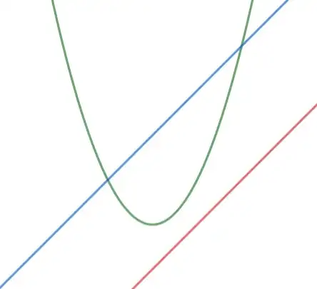

Thinking about it, I came to the conclusion that no curve could have this property: If a line cross a curve in two points, then one of the semi-planes determined by the line must contain a limited section of the curve, therefore, there is a parallel line in this semi-plane that doesn't cross the curve at all.

    "If a line cross a curve in two points, then one of the semi-planes determined by the line must contain a limited section of the curve" You are switching back and forth between "intersect" and "cross" here. Intersect is clear enough as a set theoretic term, whereas "cross" is much more difficult to define and gets into topology. And a curve can certainly intersect a line at exactly two points and still have both semi-planes contain an unbounded section of the curve (consider $y=0$ and $y=x^2(x-1)$). So more care would be needed to make that argument work. – M W Sep 23 '23 at 05:49
  • @MyMolecules I think a finite set of curves would be more impressive, but my curiosity extends to the infinite case as well. – Alma Arjuna Sep 23 '23 at 06:15
  • @MW I see, there is a flaw in my argument... The statement seems to be true still. – Alma Arjuna Sep 23 '23 at 06:20
