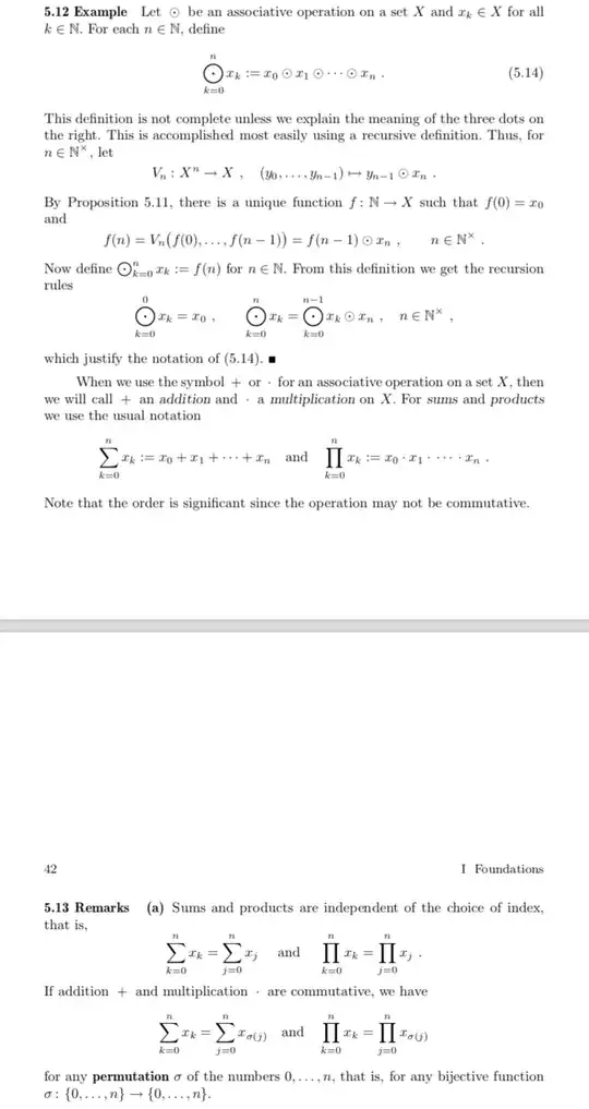

I am working on Exercise 1 of Amann and Escher Analysis I, and the problem is essentially asking:
Show that if $X$ is a set with a commutative and associative (addition) operation defined thereon, then $\sum_{j=0}^n x_j = \sum_{j=0}^n x_{\sigma(j)}$ where $\sigma$ is any permutation (bijection) of $\{0,1,...,n\}$.
I am really baffled as to how to even start. It's obviously true, but I need to prove it using the recursion theorem of set theory (Amann and Escher's Proposition 5.11). I understand how the standard sum notation ought to interpreted. I've written:
We must first interpret the notation $\sum_{j=0}^n x_{\sigma(j)}$. Given the definition for general associative operations in Example 5.12, one is led to presume that this notation refers to a recursive definition which is induced by the original. The original $\sum_{j=0}^n x_j$ is technically defined by Prop 5.11 in terms of some sequence $x_0,x_1,x_2,...$ in $X$ and some sequence of functions $V_n: X^n \to X, (y_0,...,y_{n-1}) \mapsto y_{n-1} + x_n$ for $n \in \mathbb{N}^\times$. Now take the unique function $f: \mathbb{N} \to X$ (by Prop 5.11) for which $f(0) = x_0$ and for all $n \in \mathbb{N}$, $f(n+1) = V_{n+1}(f(0),...,f(n)) = f(n) + x_{n+1}$. Then define $\sum_{j=0}^n x_j := f(n)$.
I am guessing that I need to interpret the notation $\sum_{j=0}^n x_{\sigma(j)}$ somehow in terms of a recursive definition related to the sequence $V_n$ which defined $\sum_{j=0}^n x_j$ (and then perhaps I need to use induction somehow?), but I can't see how given that $\sigma$ is defined for fixed $n$, among other things. Can anyone provide a hint or even a sketch of a proof, with careful attention paid to what $\sum_{j=0}^n x_{\sigma(j)}$ really means?
For those interested in all the gory details of what I have, I have attached a couple pictures of relevance, but hopefully my question is valid as it stands. enter image description here enter image description here

  • You can start by noticing that for any sum we can bring an arbitrary term to the front and get the same sum. This can be proved with just induction and the commutativity axiom since all we are doing is repeatedly swapping two terms in the sum. Then, given a permuted sum of length n, we can reduce the problem to one for a permutation of length n - 1 by moving the ith term to the front where i is the index of 0. Then the result follows from another induction. – scleaver Sep 18 '23 at 01:44
  • I’m afraid I don’t quite follow @scleaver if you get the chance, would it be possible to flesh out some of the details in an answer? My main sticking point right now is even in giving a definition (recursive definition) for the permitted sum, as for the “native” sum. – EE18 Sep 18 '23 at 02:30

Here's a sketch of what I had in mind in my comment, or something like it. I may be overcomplicating this but I'm trying to be explicit to avoid confusion over notation.
Let $x: \Bbb N \to X$ be a sequence and for all $n \in \Bbb N$ and all permutations $\sigma$ of length $n + 1$ define $$\sum_{j=0}^nx_j := f(n)$$ $$\sum_{j=0}^nx_{\sigma(j)} := f_\sigma(n)$$ where $f$ is the sequences of partial sums defined as in the book which satisfy $$f(0) = x_0$$ $$f(n) = f(n - 1) + x_n$$ and $f_\sigma$ is defined analogously so that it satisfies $$f_\sigma(0) = x_{\sigma(0)}$$ $$f_\sigma(n) = f_\sigma(n - 1) + x_{\sigma(n)}$$ The claim is$$\forall n \in \Bbb N : \forall \sigma: \{0, 1, ...n \} \leftrightarrow \{0, 1, ...n \}:f(n) = f_\sigma(n)$$
The base case is trivial since if $n = 0$ then $\sigma: \{0\} \leftrightarrow \{0\}$ is the identity so $f(0) = f_\sigma(0) = x_0$. Now assume $n > 0$ and $$\forall k < n: \forall \sigma: \{1, 2, ...k\} \leftrightarrow \{1, 2, ...k\}:f(k) = f_\sigma(k)$$
If $\sigma(n) = n$ then $f_\sigma(n - 1)$ corresponds to a permuted sum of length $n - 1$ so we can use the induction hypothesis to show $$f_\sigma(n) = f_\sigma(n - 1) + x_n = f(n - 1) + x_n = f(n)$$
If $\sigma(n) \ne n$, the idea is to swap the position of the $x_n$ term that's somewhere in the partial sum $f_\sigma(n - 1)$ with $x_{\sigma(n)}$, resulting in $f_\sigma(n) = f_{\sigma'}(n) = f(n)$ for some $\sigma'$ such that $\sigma'(n) = n$. So it suffices to show that the result is true for transpositions, ie, permutations that just swap two elements, because $\sigma' = \tau \circ \sigma$ for some transposition $\tau$, so we can let the initial sequence be $x_{\sigma(n)}$ and get $f_\sigma(n) = f_{\tau\sigma}(n) = f_{\sigma'}(n)$.
I'll leave the rest out for now, including the actual use of commutativity, but that's the idea. If you can prove that permuted sums are equal when the permutation is a transposition then the rest should follow.

  • Thank you for this! I have two quick follow-up questions if that's OK. (1) The first is around the definition of $f_\sigma$ and why or how it is well-defined (this was the issue I was trying to convince myself of in the OP). Given an $n$, we are further given a $\sigma: {0,...,n} \to {0,...,n}$ and, given both of those, you can then seemingly define $f_\sigma$. But I'm hoping you can clarify via Prop 5.11 exactly why this $f_\sigma$ exists. – EE18 Sep 20 '23 at 13:16
  • For instance, I can convince myself of why $f$ exists by Prop 5.11, because I can define (given the fixed sequence $x$) the sequence of functions $V_n: X^n \to X, , (y_0,...,y_{n-1}) \mapsto y_{n-1} + x_n$. With this sequence and $a = x_0$ fixed, $f$ is now well-defined. But I can't see how we would do this so as to define $f_\sigma $ likewise by this recursion theorem. For fixed $n$, would you fix the sequence as $V^\sigma_m: X^m \to X, , (y_0,...,y_{m-1}) \mapsto y_{m-1} + x_{\sigma(m)}$ for all $m \leq n$, and then make an arbitrary assignment for $m > n$ since we don't care about those? – EE18 Sep 20 '23 at 13:18
  • (2) I just want to understand your argument at the end better. Are you saying that if I can show that permuted sums are equal when the permutation is a transposition, then I will have reduced the arbitrary permutation case to the $\sigma(n) = n$ case you noted first? – EE18 Sep 20 '23 at 13:20
  • With respect to my question (1) here, that is sort of what I was trying to get at with my "interpret the notation" in the OP. I'm just hoping to fully clarify said interpretation in the context of the recursion theorem (Prop 5.11). – EE18 Sep 20 '23 at 13:22
  • Given some $\sigma$ we can extend to a sequence in $\Bbb N$ by acting on everything above $n$ as the identity and compose with $x$ to get a new sequence which we can use with Prop 5.11. – scleaver Sep 20 '23 at 13:22
  • and yes to your second question – scleaver Sep 20 '23 at 13:24
  • Sorry for being uber pedantic and slow here, I just want to confirm I "get it". At any rate, you are saying that given some $\sigma$ we can extend it to a sequence $s : \mathbb{N} \to X$ where (as for any extension) the restriction of $s$ to the first $n+1$ naturals is $\sigma$ (I have not seen sequences yet in my text which is why I ask). Then, for $f_\sigma$ one has the induced (from the $V_m$ of $f$) sequence $V_m: (y_0,...,y_{m-1}) + x_{s(m)}$ and that is, in turn, enough to define $f_\sigma$ (given the choice $f_\sigma(0 = x_{\sigma(0)$) per Prop 5.11? – EE18 Sep 20 '23 at 13:32
  • I'm not sure how to view this as composition with $x$, hence why I ask. – EE18 Sep 20 '23 at 13:33
