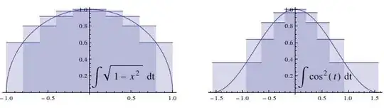

By way of example, take a look at the integral over the half circle $\sqrt{1-x^2}$, with the transformation $x=\sin(t)$. You can see how the uniformly distributed widths in $x$ get "squeezed" differently in $t$: enter image description here

    On the left picture $dt$ should be $dx$ – Maesumi Aug 27 '13 at 09:53
