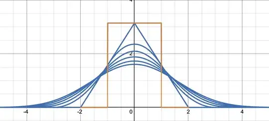

We're going to compute the general formula for $\widehat {f_n}(\omega)$. Note: Those Fourier transforms are known as box splines and are important in numerical analysis and interpolation. This is what they look like: enter image description here
