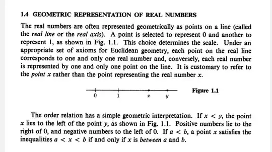

Consider this fact that we all know from school mathematics: There is a one to one correspondence between real numbers and points of a line. But the problem is I have never seen a rigorous proof of this fact.
apostol
This is what Apostol writes. And similar is the case with other modern analysis books.
So my question is, where can I find the proof of this one to one correspondence. I don't care if geometry is in Hilbert's axioms or Tarski's or anyone else all I care about is correspondence.
