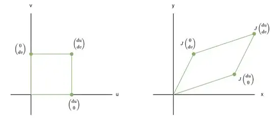

Thankfully the Jacobian allows us to map between the 2 planes and is defined as: $$ \left(\begin{matrix} dx \\ dy \end{matrix}\right) = J \left(\begin{matrix} du \\ dv \end{matrix}\right) $$
Or more graphically:
The key bit to realise is that the area of this shape in the x/y plane (this "shape" being our square in u/v plane after its been mapped to the x/y plane) is equal to the determinant of the matrix of the transformed basis vectors e.g.
$$ \left| J\left(\begin{matrix} du & 0 \\ 0 & dv \end{matrix}\right)\right| = \left| J\right| \cdot \left|\left(\begin{matrix} du & 0 \\ 0 & dv \end{matrix}\right)\right| = \left| J\right| \cdot du \cdot dv $$
Thus we can now say that the volume of our cuboid in the u/v plane equals:
$$ \underbrace{f\Big(f_1(u,v), f_2(u,v)\Big)}_\text{height in the x/y plane} \cdot \underbrace{\left| J\right| \cdot du \cdot dv}_{ \substack{ \text{area of the base square} \\ \text{in the x/y plane} }} $$
