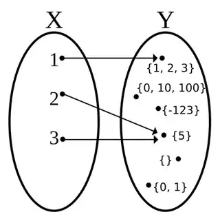

The elements of the codomain can also be sets themselves.

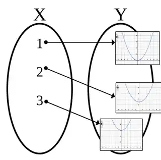

You can even have something like a family of related real functions controlled by some parameter as your codomain, and then you can have a function that takes a real number, and for each input outputs a single function from that family. And then you can use the resulting function to extract values by applying it to elements of its domain.
So you can have multiple resulting values "bundled" together, or otherwise somehow encoded. Again, what you can't have is output ambiguity given a certain input.
