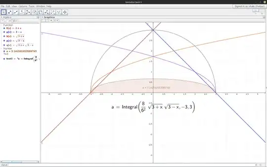

Here is what I know.
Preview integral example.
We are so close!

    Have you used the fact that you sum is approximately $8\int_0^1\sqrt{x(1-x)}\mathrm{d}x$ when $n$ is large? You can find this integral using elementary methods, and you'll get that it equals $\pi$. – Matthew H. Aug 03 '23 at 02:06

  • @Vitalie That integral is $B(3/2,3/2)=\pi/8$ in terms of the beta function. – Gary Aug 03 '23 at 02:09

  • @Vitalie You have to understand that mathematics is not always simple. You can try to compute the integral by substituting $x=\sin^2 t$, $0<t<\pi/2$. – Gary Aug 03 '23 at 02:12

    The sum $\frac{1}{{n^2 }}\sum\limits_{i = 0}^n {\sqrt {i(n - i)} } = \frac{1}{n}\sum\limits_{i = 0}^n {\sqrt {\frac{i}{n}\left( {1 - \frac{i}{n}} \right)} } $ is a Riemann sum for the integral $\int_0^1\sqrt{x(1-x)}\mathrm{d}x$, whose value is $\pi/8$. This is what you are observing numerically. Read about the Riemann integral. There is no way forward in mathematics if you are not willing to learn and understand new, perhaps more difficult concepts. – Gary Aug 03 '23 at 05:07
