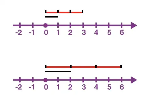

If you consider the reals as a 1D vector space, multiplication by a scalar can be thought of in the following way: you take an input number (a 1D vector), and you multiply it by a given scalar - the result then has the same relationship to the original input as the chosen scalar has to the number one (1).
E.g., suppose you're multiplying by $3$; if I denote the "input" number by underlining it, then $\underline{2} \cdot 3 = 6$ because $6/2$ is the same as $3/1$. In other words, you are scaling the input by $3$.
In the image below, imagine taking the two bars, and uniformly stretching them, keeping the starting end at zero, so that the other end of the black bar ends up above $2$. The length of the red bar is the result.

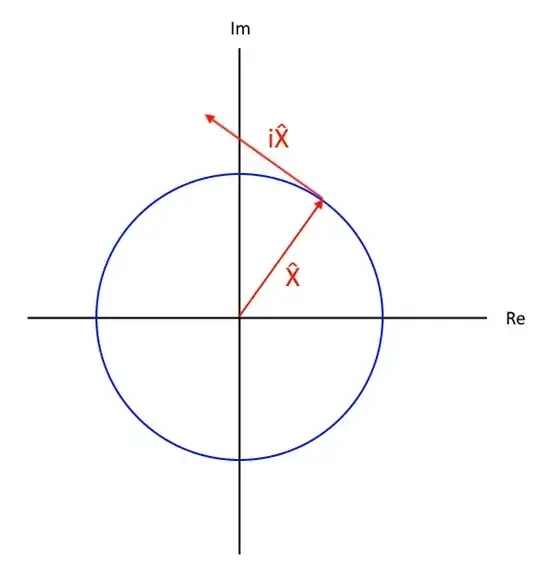

The unique property of a unit vector rotating counter-clockwise at unit-speed is that, at all times, its velocity-vector is just itself rotated 90° to the left. In the complex plane, rotating a vector 90° to the left is conveniently accomplished by multiplying by $i$
Complex rotating
Therefore, at all times, the rotation satisfies the differential equation:
$$x'(t) = i * x(t)$$
One solution to this (with the appropriate initial-condition) is $x(t) = e^{it}$.
Thus on the complex plane, exponentiation to an imaginary power is a rotation. And since exponentiation is easy to work with for many things (especially Calculus-related things), that makes complex numbers a convenient tool when dealing with rotation.
