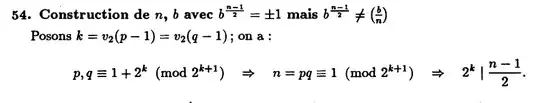

3) The third option is quite common though, for example, if $x\in\mathbb{R}$ then $$|x-2|<3\quad\Rightarrow\quad -3<x-2<3 \quad\Rightarrow\quad -1<x<5$$ Another example (from page 375 of the book P. Naudin, C. Quitté, Algorithmique algébrique avec exercices corrigés, 1992): enter image description here Also in this book Proofs and Mathematical Reasoning there are plenty of examples of implication chains (eg. page 13-14).
