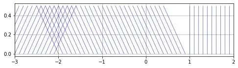

No, you did not get the solution right. Let's draw the characteristics as they are close to the initial condition
Where the lines cross, there is a shock wave, here a standing wave, and where the lines are missing there will be a rarefaction wave, essentially filling the sector with rays from the point at the bottom.

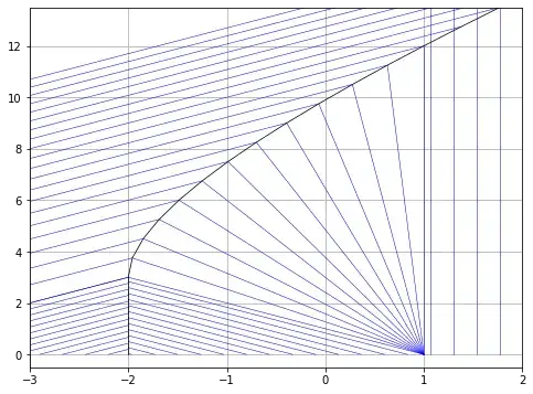

Now we get intersecting lines from the left-most segment and the rarefaction rays. This is a dynamical situation, the shock wave gets computed via a differential equation $$ x_S'(t)=\frac{1+(x_S(t)-1)/t}{2}, ~~~x_S(3)=-2,~~ t\ge 3. $$ With its solution the shock wave continues on a parabolic path
Again there are unresolved intersections, now of rays from the left-most and right-most segment. The shock wave thus continues with constant slope $\frac12$. Remember that the slope of the ray is equal to the value of $u$ at each specific point.
