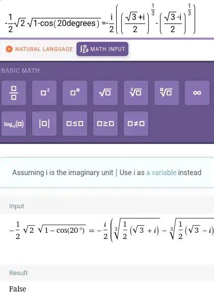

$$\sin(1\a0)=\pm\sqrt{\dfrac12(1-\cos(20))}$$$$=\pm\sqrt{0.5-\dfrac{\cos\left(\dfrac\pi9\right)}2}$$$$=\pm\sqrt{\dfrac{1-\cos\left(\dfrac\pi9\right)}2}$$Which, if we wanted to simplify this even further, we would get$$\pm\dfrac12\cdot\sqrt2\sqrt{1-\cos\left(\dfrac\pi9\right)}$$Setting this equal to the answer posted by @Robert Israel:$$\pm\dfrac12\cdot\sqrt2\sqrt{1-\cos\left(\dfrac\pi9\right)}=\frac{\omega - \overline{\omega}}{2i} = -\frac{i}{2} \left( \left(\frac{\sqrt{3}+i}{2}\right)^{1/3} - \left(\frac{\sqrt{3}-i}{2}\right)^{1/3}\right)$$And when we plug this into Wolfram Alpha, it turns out that the two equations are only equal to each other when $\sin(2\a0)$ is positive:
And when $\sin(2\a0)$ is negative:
Imgur links for reference if they are not loading:
Test for when the sine of x over 2 yields a positive result
Test for when the sine of x over 2 yields a negative result
My question
Why is it, that when we achieve the solution for the exact solution for $\sin(1\a0)$ using the formula for finding the exact value of $\sin\left(\a{\dfrac x2}\right)$, it is only equal to the exact value of $\sin(1\a0)$ that the answer to my last question received only when the formula for $\sin\left(\a{\dfrac x2}\right)$ provides a positive result?

    $\sin{20º}$ cannot be negative. Have a look at unit circle and what values of $\sin$ are positive and negative. Go by quadrants. Which quadrant does angle $20º$ land in? Is $\sin$ positive there? The half-angle formula for $\sin$ that you stated encloses all quadrants, hence positives apply to certain angles and negatives to other. See Unit Circle. – Dstarred Jun 03 '23 at 09:45
