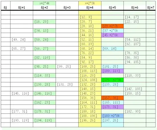

I have found a sequence of 67,108,863 consecutive numbers that all have the same Collatz length (height). These numbers are in the range $[2^{1812}+1, 2^{1812}+2^{26}-1]$ and I believe it is the longest such sequence known to date. Also I believe that we can obtain arbitrarily long such sequences if we start from numbers of the form $2^n+1$. I would be very interested to see a proof of this though. I have created an OEIS sequence for this: https://oeis.org/A277109
    By an amazing coincidence, the run of consecutive numbers described in my answer had already been discovered more than fifteen years ago by Guo-Gang Gao, the author of a paper referenced on your OEIS sequence page! – Isaac Saffold Jun 26 '20 at 20:54

There's nothing special about these numbers, as far as I can see. In fact, there are probably arbitrary long sequences of consecutive numbers with identical Collatz lengths. Here's a heuristic argument:
A number $n$ usually takes on the order of ~$\text{log}(n)$ Collatz steps to reach $1$.
Suppose all of the numbers between $1$ and $n$ have random Collatz lengths between $1$ and ~$\text{log}(n)$. Then, if we choose a starting point at random, the probability that the next $X$ consecutive numbers all have the same Collatz length is ~$\text{log}(n)^X$. There are ~$n$ possible starting points, so we want $X$ so that the probability is $\text{log}(n)^X \cong \frac{1}{n}$. Then I'd expect the longest sequence to have around $X$ consecutive numbers.
As it turns out, $X=\frac{\text{log}(n)}{\text{log}\text{log}(n)}$ does the trick.
TL;DR: between $1$ and $n$, the longest sequence of consecutive numbers with identical Collatz lengths is on the order of $\frac{\text{log}(n)}{\text{log}\text{log}(n)}$ numbers long.

Here is a table, from which one can get an idea, how to determine $analytically$ high run-lengthes ("cecl"). They seem to appear periodically with distances of powers of $2$ but most of them with magic first occurences. Perhaps someone more involved detects the complete system for this.
I simply documented the $n$ where two consecutive equal lenghtes occur, so we find such $n$ where $\operatorname{CollLen}(n)==\operatorname{CollLen}(n+1)$ . In the table we have $ [ n, \text{CollLen} ]$ where $n$ is the number tested, and $\text{CollLen}$ the trajectory length for iterating $n$.
In some cases I inserted the periodlength over the rows of the table as power-of-2 instead : $[ n +2^l \cdot k ] $ which was tested to be true up to $n=200000$ or the like. Of course, connections of two or more consecutive entries represent accordingly higher "cecl"s, so after decoding the periodicity in this table we shall be able to prognose the occurence of such higher "cecl"s.
For the most simple example, the numbers $n \equiv 4 \pmod 8$ we can have the formula with some $n_0$ and the consecutive $m_0=n+1$ which fall down on the same numbers $n_2 = m_2$ after a simple transformation either (use $n_0=12$ and $m_0=13$ first): $$ \begin{eqnarray} & n_1&=n_0/2^2 &\to n_2 &= 3 n_1 + 1 &\qquad \qquad \text { because $n_0$ is even}\\ & m_1&= 3 (n_0+1)+1 &\to m_2&= m_1 / 2^2 &\qquad \qquad \text { because $m_0$ is odd}\\ \text{and} &n_2 &= m_2 &&&\qquad \qquad \text{is wished} \end{eqnarray}$$
The first row set requirements on the structure of $n_0$: if it shall be divisible by $4$ but not by $8$ (so only two division-steps occur) it must have the form $n_0=8a_0+4$
Then we have $$ \begin{eqnarray} 3\left({8a_0+4 \over 2^2 }\right)+1 &= 3(2a_0+1)+1 &= 6a_0+4 \\ {3(8a_0+4+1)+1 \over 2^2 } &= {24a_0+16 \over 2^2 } &= 6a_0+4 \\ \end{eqnarray}$$ which result in the same number.
I think, the other types of numbers n, which lead to $cecl=2$ solutions can be obtained analoguously by analytical formulae for other trajectory-lengthes. $cecl \ge 3$ occur then when two or more $cecl=2$ solutions are consecutive based on the modular requirements which have (yet) to be described.
I would like to build upon @DmitryKamenetsky 's answer. The numbers of the form $2^n+k$ Where $n$ is sufficiently large quickly converges into a much smaller set of numbers. Dmitry's example in particular where $n$ is $1812$ and $k$ is in the range $1$ to $67108863$ converges to $117$ numbers in less than $800$ steps.
Dmitry's numbers are best analyzed in binary. All of them take the form $1000...000k$ where $k$ is in binary form just appended at the end of the $1$ with a large number of zeros. There are three operations in collatz conjecture ($+1$,$*3$,$/2$). The $+1$ and $/2$ only change the right most portion of the number, so only the $*3$ operator changes the left leading $1$ in the number. The left portion (the $1$) and the right portion (the $k$) of the number are separated by so many zeros that there is no carry over from one section to another until much later. So basically the sections act independently for some time. Where the left leading $1$ gets multiplied by three at each odd step and the $k$ follows the normal collatz rules.
The sequence http://oeis.org/A006877 are the record holders for the number that takes the most amount of time to reach $1$. $63728127$ is the largest number in the sequence that is less than $67108863$. It takes $949$ steps to reach $1$. There are no other numbers up to and including $67108863$ that take the same number of steps as $63728127$.
The point at which the two sections fully converge is when the full number (Dmitry's number) takes $n$ even steps. $1812$ is greater than $949$, so at some point all of the numbers will turn into the binary form $3^a000...0001$ where $3^a$ (in binary) is appended to the front of a set of zeros followed by a one and $a$ is the number of odd steps needed to get to that number. When this happens the number follows a three step cycle that removes two zeros from the middle block of zeros and add one to the exponent of the power of three. $3^a000...0001$ is an odd number so an odd step is applied to get $3^{a+1}000...100$ then an even step to get $3^{a+1}000...10$ then a second even step to complete the cycle $3^{a+1}000...1$. This cycle is repeated until one of two outcomes happens. The first outcome is $2*3^{b-1}+1$ and $4*3^{b-1}+1$ (if these expressions were in binary form this would be $3^{b-1}$ appended in front of a $1$ or a $01$.) In both cases they are odd so an odd step is applied to get $2*3^{b}+4$ and $4*3^{b}+4$. Then one even step is applied to the first case and two even steps are applied to the second case to get $3^{b}+2$ and $3^{b}+1$. These two last expressions are when the left and right portions have completely combined.
Just as $k$ represents a set of numbers, $b$ also represents a set of numbers. How long it takes to go from $2^{1812}+k$ to $3^b+1$ or $3^b+2$ is $1812$ plus the number of odd steps ($b$). The number of odd steps is dependent on $k$. Using a computer program I found all $k$ except one falls into the range $894-951$. (the record holder I mentioned earlier) $63728127$ uses $967$ odd steps to get to one of the two final forms.
There are $58$ numbers in the range $894-951$ which each have two forms and the record holder has one. So the total number of unique numbers at this point is $58*2+1=117$. Now an important thing to note is that the two forms using the same $b$ require the same number of steps. If $b$ is odd then $3^b\mod 8\equiv 3$. If $b$ is even then $3^b\mod 8\equiv 1$. With this knowledge in hand The $117$ unique numbers can be reduced even further. If $b$ is odd then the form $3^b+1\mod 8\equiv 4$. This means it is divisable by $4$ but not $8$. So if two even steps then an odd step is applied we get $\frac{3^{b+1}+7}{4}$. This means that $3^{b+1}+7$ is divisible by $4$. If we apply an odd step then two even steps to the second form ($3^b+2$, when $b$ is odd) we also get $\frac{3^{b+1}+7}{4}$. This means that $29$ of the $117$ later converges to one of the other numbers this leaves $88$ remaining.
I think that this information will make it much easier to figure out if Dmitry's strategy can be generalized or not. One last thing to note is that when doing an analysis on the set of numbers with two forms with different values for $b$; how quickly these numbers turn into one of the two forms ($3^b+1$ and $3^b+2$) is dependent on $b$. So the first set of numbers that turns into one of the two forms is when $b=894$. One step after that the set of numbers that turns into one of the two forms is when $b=895$. Then one step after that the set of numbers that turns into one of the two forms is when $b=896$. etc.
