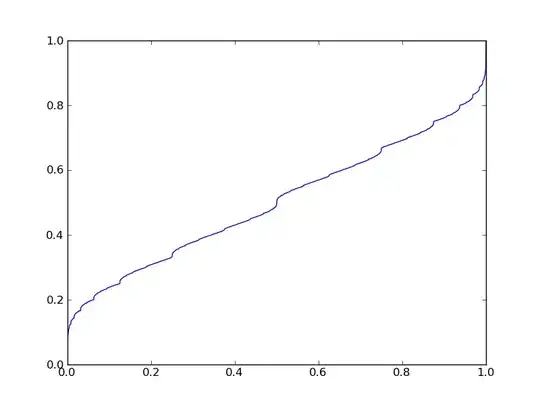

During computation of some Shapley values (details below), I encountered the following function: $$ f\left(\sum_{k \geq 0} 2^{-p_k}\right) = \sum_{k \geq 0} \frac{1}{(p_k+1)\binom{p_k}{k}}, $$ where $p_0 > 0$ and $p_{k+1} > p_k$ for all $k$. In other words, the input to $f$ is the binary expansion of a real number in the range $[0,1]$, and the $p_k$ correspond to the positions of $1$s in the binary expansion.
For example, $f(2^{-t}) = 1/(t+1)$, so $f(1/2) = 1/2$, $f(1/4) = 1/3$ and so on. More complicated examples are $f(5/8) = f(2^{-1} + 2^{-3}) = 1/2 + 1/(4\cdot 3) = 7/12$ and $$ f(2/3) = f\left(\sum_{k \geq 0}2^{-(2k+1)}\right) = \sum_{k \geq 0} \frac{1}{(2k+2)\binom{2k+1}{k}} = \frac{\pi}{\sqrt{27}}.$$
The function $f$ is a continuous increasing function satisfying $f(0) = 0$, $f(1) = 1$, and $f(1-t) = 1-f(t)$ for $t \in [0,1]$. It has vertical asymptotes at dyadic points.
Here is a plot of $f$:plot of f
Is the function $f$ known?

It is an example of a Singular Function (Generalized De Rahm curve).
You can try to identify the contraction maps.
