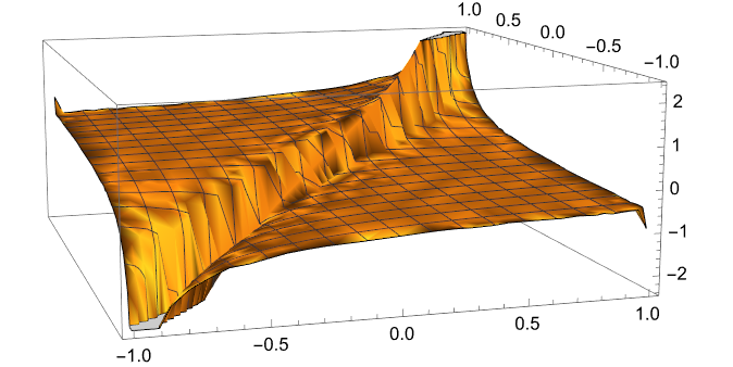

I did some numerical calculations and it seems the expression shouldn't be so complicated. On Figure 1 is $S(x,y)$ with $x=1/2$ and $y$ being the $x$ axis. As $x$ moves, the point of discontinuity shifts, it is always at $y=x$.

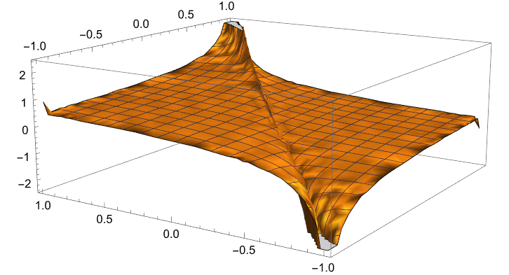

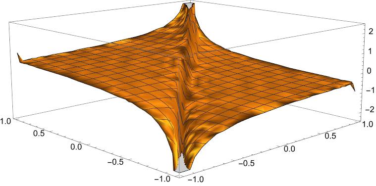

  • Interesting problem! Indeed the graph of $S$ looks like it admits quite some structure; the simple mathematica code f[x_, y_, nmax_] := Sum[LegendreP[n, x]*LegendreP[n + 1, y], {n, 0, nmax}] Plot3D[f[x, y, 600], {x, -1, 1}, {y, -1, 1}] produced the following images: 1 2 3. While I think the bends at $(-1,1),(1,-1)$ are truncation artifacts, I'm not so sure the same is true at $(-1,-1),(1,1)$ – Frederik vom Ende May 09 '23 at 06:19
  • @FrederikvomEnde For $y=1$ the function is just $S(x,1) = 1/ \sqrt{2 - 2x}$ (it's the F generating function) and we see that the bends at $(-1,1)$ and $(1,-1)$ are indeed just a numerical error, the real value there is $1/2$ at $(-1,1)$ and $-1/2$ at $(1,-1)$. From the same reason the value at $(1,1)$ is diverging to $+ \infty$ and value at $(-1-1)$ to $- \infty$ (because $P_l(-1) P_{l+1}(-1) = -1$) . I am not sure whether all the values at $x=y$ are diverging but my guess is yes. – Jakub Konarek May 09 '23 at 11:05
