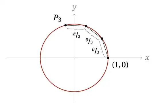

A few years ago, I saw an article that showed that it was possible to derive the power series for sine and cosine using a tail-to-tip chord approximation in the unit circle.
Basically, one first create a chord of length $0 \leqslant \theta \leqslant 2$ starting from the origin point $(1,0)$ to a point $P_1$ on the unit circle.
Now, if you divide the length $\theta$ by a given constant $n$ and create a sequence of multiple tail-to-tip chords, then you have $n$ points on the unit circle from $P_1$ to $P_n$ and the total length [of all chords] remains $\theta$.
You want to find the couple $(x_n,y_n)$ by solving the tail-to-tip recurrence system given by

I don't write the direct solution, but present the method.
In general, the whole procedure seems unnecessarily complicated. Basically, the angle in radians is the arc length parameter on the unit circle, starting at (x,y)=(1,0). The chord approximates the arc length s, i.e. $\theta \to s$ as $n \to \infty$.
On mathematical grounds, I'd also question the method, because cos and sin are nowadays DEFINED by the series. So, it could rather be a method for motivating the series definition of sin and cos.
But as for the method: For the case with n chords, denote the points by $P_{n,k}\, $, $0 \leq k \leq n$, and $P_{n,0} = (1,0)^t$. enter image description here Your formula for P1 holds in any case for $P_{n,1}$ with $\theta$ replaced by $\theta / n$:
$P_{n,1} = \begin{bmatrix} 1 - (\frac \theta n)^2 / 2 \\ \frac\theta n \cdot \sqrt{1-(\frac \theta n)^2 / 4} \, \end{bmatrix}$
You know, that this is ($\cos(\phi) , \sin(\phi)$) for some angle $phi$ related to $\theta$.
Whith these entries, build the matrix which provides rotation about the origin through that angle $\phi$, but take $\frac\theta n$ as the argument:
$ R(\frac \theta n) = \begin{bmatrix}1-(\frac \theta n)^2/2 & -\frac\theta n \cdot \sqrt{1-(\frac \theta n)^2 / 4} \\ \frac\theta n \cdot \sqrt{1-(\frac \theta n)^2 / 4} & 1-(\frac \theta n)^2/2 \end{bmatrix}$
The first column is the coordinates of the point $P_{n,1}$ which is $(1,0)$ rotated through $\phi$. The second column is $(0,1)$ rotated through $\phi$, so it makes a right angle at the origin with $P_{n,1}$.
By using the rotation matrix, the coordinates of the points are obtained as
$P_{n,k} = R(\frac \theta n)^k \begin{bmatrix}1\\0\end{bmatrix}$
Now, compute $R(\frac \theta n)^n$ and prove the formula by induction over n. (Your formula has misprints, I guess.)
