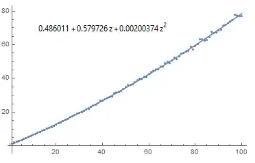

I've simulated it for N=1 up to 100. It appears to resemble $N^{-2}$ so I plotted $1/\sqrt{f(N)}$ and the best fit parabola. It's a decent match but there's still a small quadratic term indicating some linear component to $1/f(N)$. Here's the plot:
This $1/N^2$ behavior matches with the results of similar questions. Maybe this question can reduce to one of these already solved:
