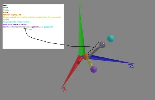

I have a point in a 3D space rotated by a quaternion. The point has a fixed length from the rotation itself (shown in image). What I'm trying to achieve is to rotate my point towards a goal position represented here by another point. if I just have the target position, the position of the rotated point, the length of the offset form my rotation origin, and the rotation (represented by a quaternion) and the rotations position (see orange sphere in picture) is it possible to find a quaternion to aim/point/translate my point towards the target position/point?
I have provided an image for details: enter image description here

  • Did I understand you correctly? You are looking for a quaternion that, when multiplied by the purple dot's quaternion representation, becomes the blue dot? – Kevin Dietrich Mar 22 '23 at 20:23
  • Would you also tell us your ideas and attempted solutions so that we can really help and not just solve the task for you. – Kevin Dietrich Mar 22 '23 at 20:24
  • maybe that this answer is what you are searching : https://math.stackexchange.com/questions/1569215/given-a-start-point-in-3d-and-a-quaternion-and-length-to-point-b-can-you-find-po/1572193#1572193 – Emilio Novati Mar 23 '23 at 10:49
