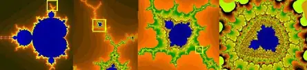

The Mandelbrot set is not self-similar in the sense that you mean -- that applies more to fractals like the Sierpinski triangle, the Koch curve, and so forth. There are several subsets of the Mandelbrot set that are approximately similar to the Mandelbrot set, as shown in this zoom sequence from Wikipedia:
Quasi-self-similarity of the Mandelbrot set
The Mandelbrot set is also infinitesimally self-similar at any Misiurewicz point, in the sense that zooming in at such a point reveals local structure that seems to repeat the farther you zoom in. (In fact, the local structure is converging to the local structure of the corresponding Julia set.)
