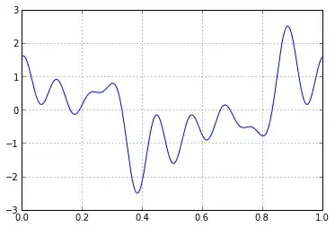

Here's an example using IPython to plot $$f(\theta)=\cos \theta+\tfrac{1}{2}\cos(3\theta+0.23)+\tfrac{1}{2}\cos(5\theta-0.4)+\tfrac{1}{2}\cos(7\theta+2.09)+\tfrac{1}{2}\cos(9\theta-3)$$
th = np.arange(0,1,0.001)
f = lambda th: np.cos(th*2*np.pi)
plt.plot(th,f(th)+0.5*f(3*th+0.23)
  +0.5*f(5*th-0.4)+0.5*f(7*th-2.09)+0.5*f(9*th-3))
plt.ylim([-3, 3])
plt.grid('on')
You'll note that $\sum |A_k| = 3$, which implies that $|f(\theta)|<3$, but here the maximum amplitude is around 2.5, because the harmonics never completely add constructively.

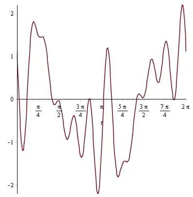

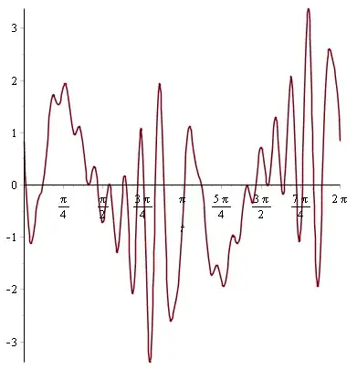

Taking a cue from Hardy-Littlewood series, I tried to shift $\cos kt$ by $k\ln k$. The results look good: harmonics fight one another all the time, pushing the function up and down. Here is the sum up to $k=11$
k11
and here is the sum up to $k=21$ (I used $1/2$ for all coefficients after the first)
k21
I don't offer a proof of anything, but shifting by $k\ln k$ is "a way that makes sense".
More precisely, I plotted $$\mathrm{Re} \sum A_k\exp( ikt+ik\ln k) = \sum A_k \cos(kt+k\ln k)$$
