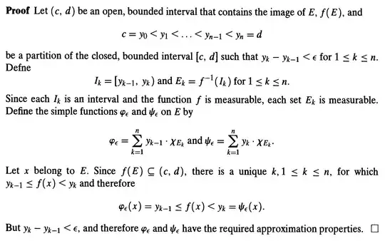

Wait...is that what simple approximation lemma and rth staircase function are about?

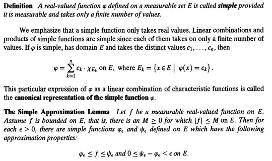

Simple approximation lemma:

  1. I think it's the same as the rth staircase function in Probability with Martingales. $k=1$ to $n$ and $i=1$ to $r$.
  2. I think the Royden Fitzpatrick Real Analysis simple functions are generalisations ...with their $k$ = PWM's $i$ and their $\epsilon$ = PWM's $\frac{1}{2^r}$ sooo there are several $\epsilon$'s here...just plug in each $r$...or something.
  3. I guess my $s_n$'s are like $\epsilon = \frac1n$ but $\epsilon = \frac1{2^n}$ would work too.
