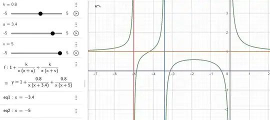

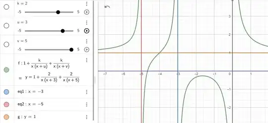

A different understanding of this phenomena can be obtained through graphical representations as those given below : the roots of $f(\lambda)$ are in between its poles ( materialized by vertical asymptotes $\lambda = 0, \lambda=-\lambda_1, \lambda=-\lambda_2$) constraining the real roots to be negative.
Fig. 1: A case with a single real eigenvalue $\lambda \approx -4.66$. Please note the horizontal asymptate $y=1$. Besides, a conjugate pair of eigenvalues can be "guessed" with negative real part $\approx -1.8$ in the vicinity of the summit of the third branch.
Fig. 2: A case with three real eigenvalues, all of them negative.
Edit (2 days after) : I agree that, as remarked by Dan, Descartes rule of signs gives the result with less calculations. The main interest of the method I have developed is that it allows to bracket the solutions, for example in Fig. 2, with 3 solutions $\lambda, \lambda', \lambda''$, we have :
$$-\lambda_1 < \lambda < -\lambda_2 < \lambda' \le \lambda'' < 0 $$
In particular, all solutions are $ > - \max(\lambda_1,\lambda_2)$
