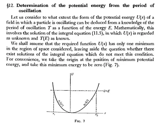

In Landau's Mechanics, there is a special trick for determining the potential energy from the period of oscillation.
Landau calculates the integral $\int_0^\alpha \frac{T(E) dE}{\sqrt{\alpha - E}}$ and then changes the order of integration, reducing the integral to $\pi\sqrt{2m} [x_2(\alpha)-x_1(\alpha)]$(You may refer to Landau's book for more details)
But why? Why should I consider the integral $\int_0^\alpha \frac{T(E) dE}{\sqrt{\alpha - E}}$. Is it just a trick? What's the motivation? Is there any deeper theory behind the trick?
