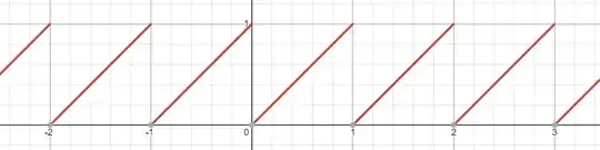

It may not always be the case. Consider the "fractional part" function:
$$f(x) := \{x\} := x - \lfloor x \rfloor$$
This function, in some sense, returns the "decimal part" of $x$. Hence
  • $f(1.5) = 0.5$
  • $f(\pi) = 0.14159...$
...though, for negative numbers, it returns the decimal part in the "other direction":
  • $f(-1.3) = 0.7$
  • $f(-2.1) = 0.9$
...and so on.
The graph itself looks like $y=x$ for $0 \le x < 1$, repeated over and over again:
Where it is differentiable, $f'$ is always positive, but clearly it is not always increasing (because of the times it jumps down).
