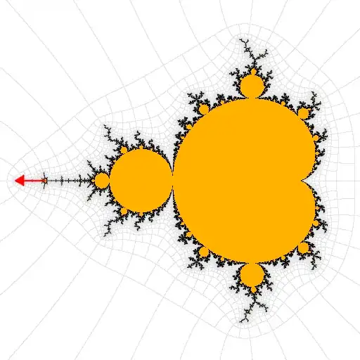

Consider the sequence of "westernmost" islands increasing in period:
westward ho
Here are some examples, you can see them increasing in hairyness / spinyness.

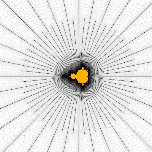

Period 20:
period 20

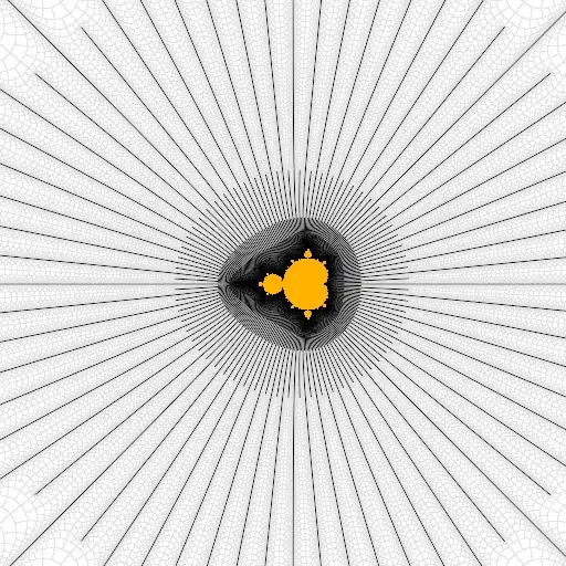

Period 30:
period 30

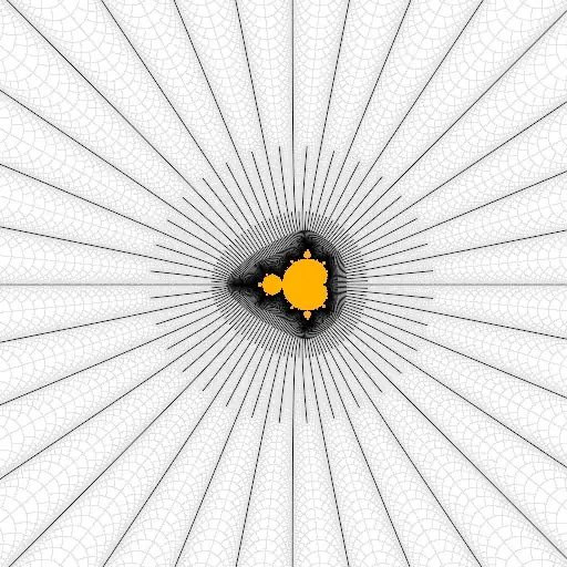

Period 40:
period 40

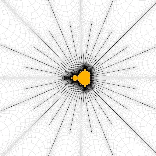

Period 50:
period 50

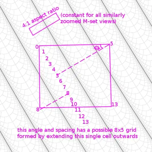

Zooming in near to a sufficiently hairy high-period island, you can get very nearly parallel spines:
period 50 zoom annotated
There is a natural grid with a 4:1 aspect ratio between successive escape time level sets in neighbouring spine gaps. (Determined by measuring images: I have no proof of this seeming fact. But it's not a strictly necessary detail.)
If you choose the angle of the spines carefully, you can create an NxN grid with square cells that satisfies "distinct level set at each pixel sampling point in an (m,n) image array".
schematic grid
There is a slight fuzziness due to the imperfect parallelism and the quantized angles available for any given period island, but increasing the period far enough and that won't matter - eventually it gets good enough for the finite width of the level sets to take care of it.
Claude
  • 5,647
  • Your answer is an idea for a proof. I think that something like that will work. Unfortunately thinking something will work is not the same as proving it works. The hard part is describing the judicious positioning. – Jay Feb 05 '16 at 15:07
  • I edited my answer, using a slightly different approach to make judicious positioning easier. Thanks for the push towards more rigour. – Claude Feb 05 '16 at 20:03
  • Thank you. That seems like it will work. There will be a certain amount of tediousness to fill in the details. – Jay Feb 05 '16 at 20:27
