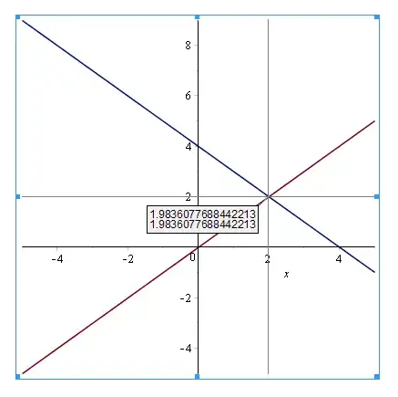

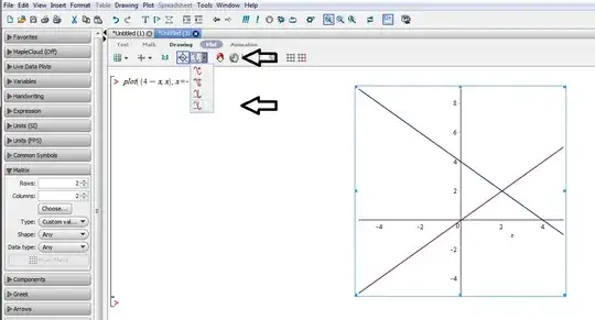

Another way is to use Maple 15, 16 or recently version 17. In this powerful software which is famous in symbolic computations, you can easily probe the point of intersection as well as other useful points in any certain plots. I could do that for you while $a=4$:
Mikasa
  • 67,374
