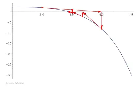

I cannot see any form of analytical solution possible to this equation. Instead, you can set a function $$f(x)=2^x-\Gamma(x+1)$$ and perform numerical methods for the second solution. You can use Newton's method for approximating roots.
Here, we start with the initial value $x=3$
and so on to the desired accuracy.
The root we get is $$x\approx 3.45986564404499913418786108106898120277518459906428314529806887...$$
