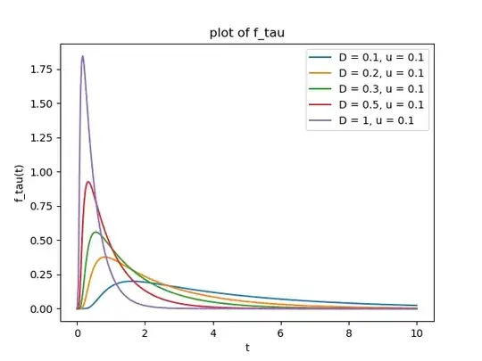

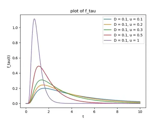

The following plots are for $a=-1$, $b=1$, $x_0=0$ and $t_0 = 0$. In the plots we have $u:=\mu$.
