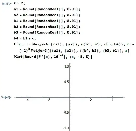

Basically, I generate three random parameters $b_1,b_2,b_3$ that are between $0$ and $1$, and rounded to two decimal places to make the following numerics easier. I then let $k$ be any integer ($1$ in this case) and let $b_4=b_1+k$, so that the difference between $b_1$ and $b_4$ is an integer. (I have set $k=1$ in the above but I find the program produces the expected result for other integer values of $k$ as well.) I then numerically evaluate and plot $$\frac{\mathrm d}{\mathrm dz}\left[G^{2,0}_{0,3}\left(\begin{matrix}- \\ (b_1,b_2,b_3,b_4)\end{matrix}\bigg|~z\right)-(-1)^{b_1-b_4}G^{2,0}_{0,3}\left(\begin{matrix}- \\ (b_4,b_2,b_3,b_1)\end{matrix}\bigg|~z\right)\right]$$
If my proposed formula is right, I would expect the graph to just be a flat line at zero. (I rounded the values to $10^{-10}$ so that it wouldn't output a bunch of machine precision noise.)
And, Lo and Behold, that appears to be the case. I have ran this program several times, for example:

I even tried putting in some upper parameters, and it still seems to work, for example
example output 2
