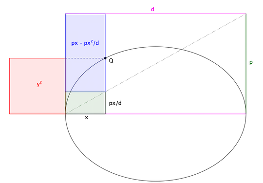

Another case which comes to mind goes back to Apollonius of Perga, and the reason he gave the conics those three names we still use nowadays.
If we choose as $x$ axis the major axis of the conic and as $y$ axis the line tangent to the conic at one of its intersections with $x$ axis, the equations of parabola, ellipse and hyperbola can be respectively written as: $$ y^2=px,\quad y^2=px -{p\over d}x^2,\quad y^2=px +{p\over d}x^2, $$ where $p$ is the latus rectum of the conic and $d$ the length of major axis. That is (quoting from Heath's comment to Conics):
if a perpendicular be erected to the diameter at that extremity of it from which $x$ is measured and of length $p$, then $y^2$ is equal [parabole] to a rectangle of breadth $x$ and "applied" to the perpendicular of length p, or falling short [ellipsis] or exceeding [hyperbole] by a rectangle similar and similarly situated to that contained by $p$ and $d$.
In the figure below one can see that in the case of an ellipse: the area of the red square ($y^2$) is equal to the area of the blue rectangle, obtained by subtracting from rectangle $px$ the green rectangle, which is "similar and similarly situated" to the big rectangle $pd$.
Intelligenti pauca
